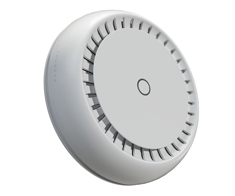

今天有人问我,想了解cAP XL ac的产品让我介绍下,其实这个cAP XL ac产品,官网还没正式发布的时候,元芳就提前发我看了,感觉今年什么都涨价,为什么MikroTik的老产品价格好像没变(汇率波动除外),这不就来了,换个马甲,加个天线就多30刀。
The new design features a larger high-gain antenna, higher sensitivity, and a built-in reflector. These improvements allow increasing the covered area by up to 100%, compared to the previous cAP models! 官方意思说比cAP ac覆盖范围提升一倍!
数据大家看看吧:

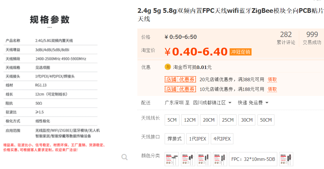

我在想自己家里的cAP ac能不能DIY了
